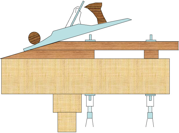

I decided to make a mock run on cutting and joining the headstock to the neck. I went to Lowes and got a 4”x4”x4’ Pine board for $3.50. I made a simple jig for my bandsaw to make the sled jig to make the cut.
Then I clamped one on top of the other to plane the cut smooth. Just like this.
One I got done, I unclamped them and I test fitted the scarf joint. I found it to appear high in the middle. So I stacked, clamped and replaned again. Repeated several times with the same results.

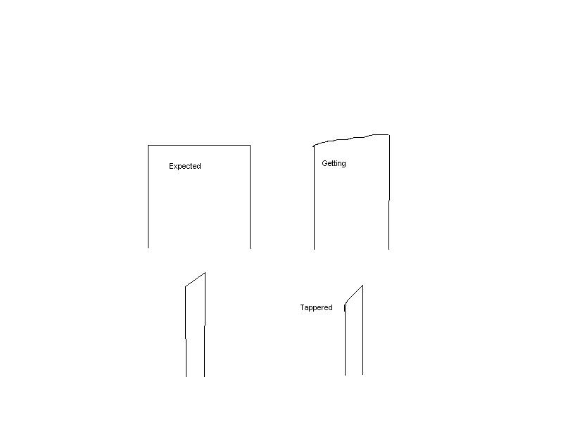

I’m also getting a bevel/taper on the joints. See the rough diagram.

Are you checking your progress with a square? That should tell you what areas to work on with the plane, and you shouldn't have to unclamp everything until you know everything's square and flat.

What Jon said. I check the scarf with a machinist square frequently while planing. I also prefer a smoothing plane for this procedure, rather than a block plane -- the larger sole seems to help keep things flat across the planed area. I also will plane the surface at an angle (maybe 30 deg. to the grain or so) for some of the strokes, because this seems to help prevent high or low spots. I would also leave it at 3.5" and then trim off the excess after the scarf is done.

What I dont understand is why its still high after I put it on the sander?

If it rocked just a little bit on the belt sander it'd be real easy to make a high spot.
Use a machinist square to draw a line across the blank where you want the scarf to start and try working to that with the plane. Then you have a reference while you're working with the plane, without having to check it with a square all the time.

What Jon and Michael said. Check often with the square, and use the plane at an angle. Also be sure you are taking very light cuts, and that the plane iron is very sharp. If you have to push hard to start/end the cut, you will inadvertently push down as well as along the cut. If you keep having problems, you can also make a flat sanding board that's about 1 inch wide, and finish off the high points with that.

The other thing to look out for when making these joints is that the underside of the neck where the scarfed peghead piece sits is absolutely flat and true. In fact it is best to make sure that the the two pieces are as square and true as possible apart from the two surfaces that you are planing. Otherwise when you try the joint dry there will be annoying gaps and wobbles - dimhikt
If it's a belt sander you are using the I find there is always some "cushioning" on the plate. You press down thinking it is sanding flat and square and then test it with a set-sqaure and find it isn't.Dave White39059.4775231481

There is some great advise. To summarize:
* Leave it at 3.5 inches, gives you 'wiggle room' also allows for a wider headstock design if you desire.
* As Dave said, check taht your pine board is flat. If it is cupped AT ALL, when you clamp it it will flatten out, you plan it, then when you release the clamps the cup shows up again and your joint will never fit.
* plane on a bias with a very sharp plane. You can also hold the plane at a bias to the grain but push it with the grain for a shearing action. That way the sole of your plane rests on the entire width of the headstock.

I do all my scarf joints with a small low angle block plane.
It gives you better control .
Then I sand with a 80 grit sanding block-takes me
3 minutes tops to get a perfect joint!
And as said before check with a square as you go.
